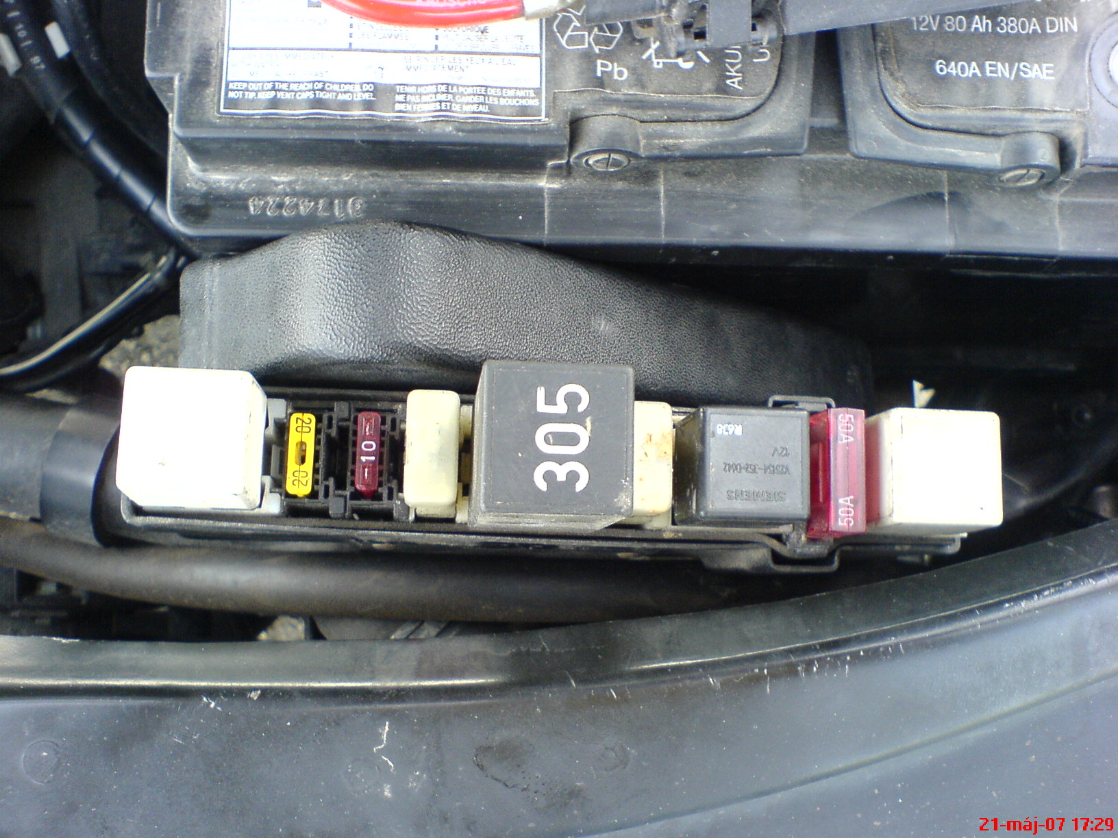

mario1977 Posted March 24, 2008 Author Share Posted March 24, 2008 ktore z tychto rele, ktore su pri baterke je na hukacku???? Quote Link to comment Share on other sites More sharing options...
Galaxy64 Posted March 24, 2008 Share Posted March 24, 2008 ktore z tychto rele, ktore su pri baterke je na hukacku???? Rollbar Ti psal, ze je to rele53 na releboxu. To co mas vyfoceny neni relebox, ale nejaka dodelavka, mozna dodelavana klima Relebox je zhruba nekde nad spojkovym pedalem, pristupny po sundani, te plastove mrizky Quote Link to comment Share on other sites More sharing options...
rolbař Posted March 24, 2008 Share Posted March 24, 2008 njn, tak jsme našel obrázek PS: ty relátka u baterky jsou na klimu DIAVIA - dodělávka Quote Link to comment Share on other sites More sharing options...
