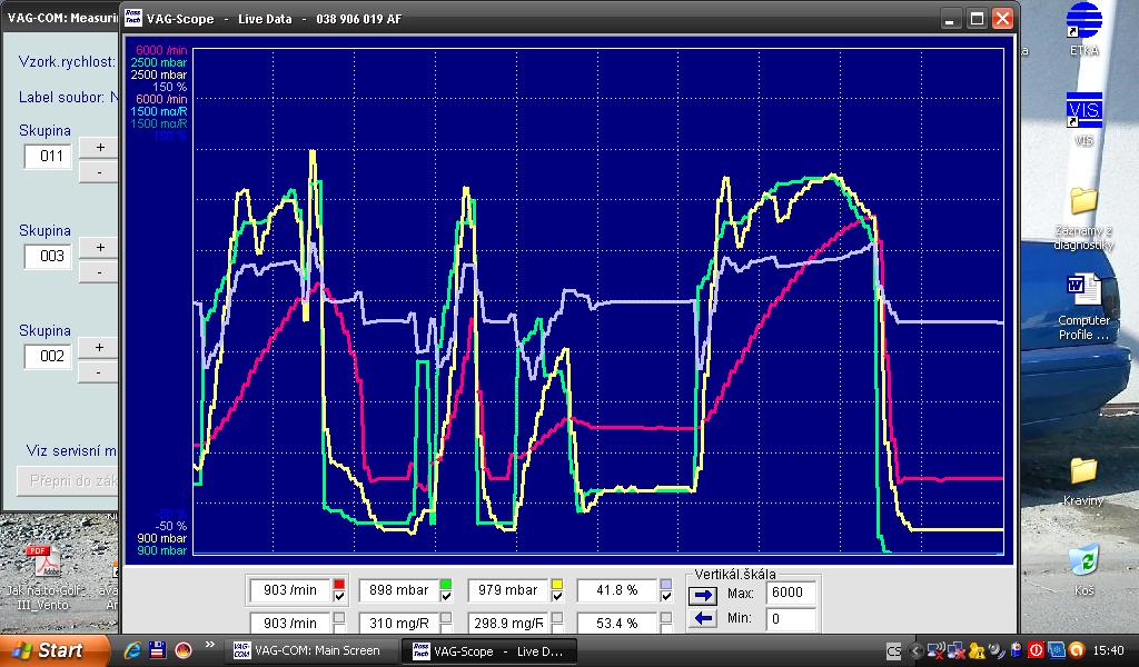

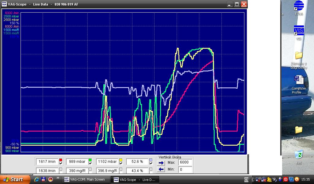

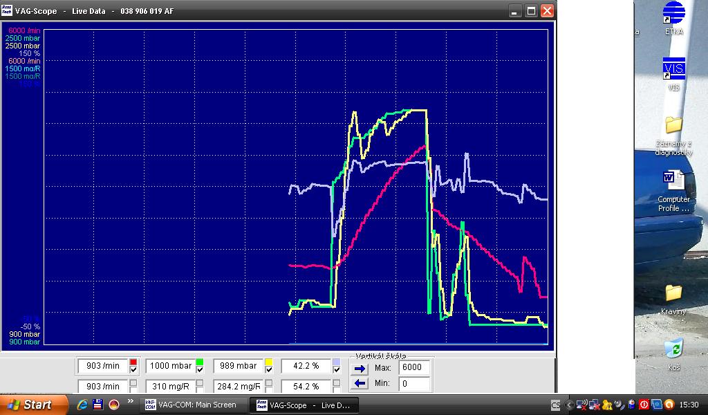

  7. Tak už jsem konečně našel někoho s VAGem a udělal mi log skupin 3,10 a 11. Tak se k tomu někdo z povolaných zkuste vyjádřit. Sunday,30,October,2011,10:24:32 038 906 019 AF ,,0000SG 1110, ,Group A:,'003,,,,Group B:,'010,,,,Group C:,'011 ,,otáčky,Vzduch/zdvih,Vzduch/zdvih,Poměr sepnutí,,Vzduch/zdvih,Absolut.tlak,Absolut.tlak,zátěž,,otáčky,Absolut.tlak,Absolut.tlak,Poměr sepnutí ,TIME,,,,,TIME,,,,,TIME,,,, MARKER,STAMP, /min, mg/R, mg/R, %,STAMP, mg/R, mbar, mbar,%,STAMP, /min, mbar, mbar, % ,0.01,966,395.0,396.9,38.6,0.41,426.3,979,1010,29.0,0.83,903,1510,1020,29.9 ,1.23,945,850.0,436.1,4.8,1.63,441.0,979,1081,100.0,2.03,1008,1520,1112,26.7 ,2.43,1029,850.0,470.4,4.8,2.83,480.2,979,1173,100.0,3.23,1113,1550,1204,25.1 ,3.66,1155,850.0,494.9,4.8,4.05,514.5,979,1265,100.0,4.46,1239,1591,1316,20.3 ,4.89,1302,850.0,563.5,4.8,5.31,588.0,979,1459,100.0,5.71,1428,1703,1550,35.1 ,6.11,1512,850.0,676.2,4.8,6.51,715.4,979,1816,100.0,6.94,1680,1816,1938,58.2 ,7.36,1785,850.0,788.9,4.8,7.77,774.2,979,2040,100.0,8.19,1974,1948,2020,64.9 ,8.59,2079,850.0,813.4,4.8,9.02,803.6,979,2060,100.0,9.42,2268,1948,1989,69.7 ,9.84,2352,845.0,749.7,4.8,10.25,730.1,979,1887,100.0,10.67,2520,1979,1867,64.5 ,11.07,2604,845.0,700.7,4.8,11.47,705.6,979,1867,100.0,11.87,2730,2009,1907,64.1 ,12.27,2793,845.0,730.1,4.8,12.67,739.9,979,1999,100.0,13.07,2940,2050,2040,68.1 ,13.47,3003,845.0,754.6,4.8,13.87,744.8,979,2081,100.0,14.27,3129,2071,2060,69.3 ,14.67,3171,845.0,705.6,4.8,15.07,705.6,979,1999,100.0,15.45,3276,2081,1999,66.9 ,15.87,3339,850.0,695.8,4.8,16.27,695.8,979,2020,94.9,16.67,3423,2091,2020,66.1 ,17.07,3423,850.0,695.8,4.8,17.47,690.9,979,2040,100.0,17.87,3486,2091,2040,64.9 ,18.27,3528,850.0,690.9,4.8,18.67,686.0,979,2060,100.0,19.08,3570,2091,2081,66.1 ,19.47,3570,850.0,690.9,4.8,19.87,690.9,969,2071,100.0,20.27,3633,2091,2071,65.3 ,20.68,3654,850.0,690.9,4.8,21.10,686.0,969,2091,100.0,21.52,3738,2091,2091,66.1 ,21.93,3759,850.0,681.1,4.8,22.33,676.2,969,2091,100.0,22.75,3822,2091,2091,66.1 ,23.15,3843,850.0,676.2,4.8,23.55,676.2,969,2101,100.0,23.96,3885,2091,2101,67.3 ,24.38,3906,850.0,676.2,4.8,24.79,676.2,969,2111,100.0,25.21,3948,2091,2101,68.1 ,25.61,3969,850.0,671.3,4.8,26.01,671.3,969,2111,100.0,26.44,4011,2091,2111,68.9 ,26.86,4011,850.0,666.4,4.8,27.27,666.4,969,2122,100.0,27.69,4053,2091,2122,70.5 ,28.09,4074,850.0,666.4,4.8,28.51,661.5,969,2122,100.0,28.89,4095,2071,2122,72.1 ,29.29,4116,850.0,651.7,4.8,29.69,651.7,969,2091,100.0,30.09,4137,2040,2081,73.3 ,30.51,4158,850.0,641.9,4.8,30.89,641.9,969,2060,100.0,31.29,4179,2030,2050,73.7 ,31.69,4200,850.0,632.1,4.8,32.09,632.1,969,2050,100.0,32.49,4200,2020,2040,74.5 ,32.89,4221,850.0,622.3,4.8,33.29,617.4,969,2020,100.0,33.69,4221,2009,2009,74.1 ,34.09,4242,850.0,617.4,4.8,34.52,617.4,969,2009,100.0,34.94,4263,1999,2009,74.5 ,48.74,1974,475.0,480.2,49.8,49.14,465.5,969,1306,42.4,48.35,1995,1244,1306,57.0 ,49.94,1953,515.0,470.4,44.6,50.34,519.4,969,1306,53.3,49.54,1974,1244,1295,57.4 ,51.14,1953,620.0,573.3,19.9,51.54,583.1,969,1499,53.7,50.74,1953,1520,1397,45.0 ,52.34,1953,720.0,588.0,19.9,52.77,632.1,969,1571,65.9,51.94,1953,1520,1520,49.4 ,53.59,1995,800.0,705.6,4.8,54.01,735.0,969,1897,73.3,53.17,1974,1836,1714,45.8 ,54.82,2016,685.0,690.9,20.3,55.21,671.3,969,1785,58.4,54.42,2016,1703,1979,62.6 ,56.02,2037,690.0,661.5,19.9,56.42,661.5,969,1734,62.7,55.62,2016,1683,1744,52.6 ,57.22,2037,725.0,700.7,19.9,57.62,705.6,969,1836,62.7,56.82,2037,1775,1775,49.8 ,58.42,2058,725.0,705.6,19.9,58.82,710.5,969,1856,62.4,58.02,2058,1775,1846,53.8

  9. Protože doporučený kabel KKL nefungoval a k bluetooth ELM327 nemám SW, který by potřebné logy dokázal zapsat a do pronájmu nějaké funkční kombinace VAG-COM + KKL už nechci podruhé investovat (udělal jsem to jednou a výsledky jsou na začátku vlákna). Z toho, co jsem při měření viděl, usuzuji, že skutečný tlak v sání dobře sleduje žádanou hodnotu v rozsahu 1800-3500 otáček (regulace turba funguje) a váhu vzduchu nepodezírám, jelikož už jsem zkoušel 3 různé kusy bez vlivu na průběh výkonu. BTW: Myslím si, že měření v reálném prostředí má pro mne větší vypovídací hodnotu než laboratorní měření na brzdě. Na brzdě není možno podchytit reálný vliv proudění okolního vzduchu na tlak v sání, reálné valivé tření pneumatik a spoustu dalších vlivů. Graf, který jsem uvedl není odhadnutý, ale vypočítaný z reálně změřených hodnot otáček, převodového poměru, průměru kola, hmotnosti vozidla, vlhkosti, teploty, Cx.... O správnosti logů na základě vnitřních čidel motoru by se dalo s úspěchem pochybovat. A o přesnosti čidel skutečného tlaku v sání po deseti letech si nedělám žádné iluze. Stačí si vzít cejchovaný barometr a porovnat to s hodnotami, které vykazují čidla při stojícím motoru (10% tolerance asi stačit nebude). Jediný, co snad může měřit přesně jsou otáčky a to jen v případě, že se nerozjel krystal v řídící jednotce.
