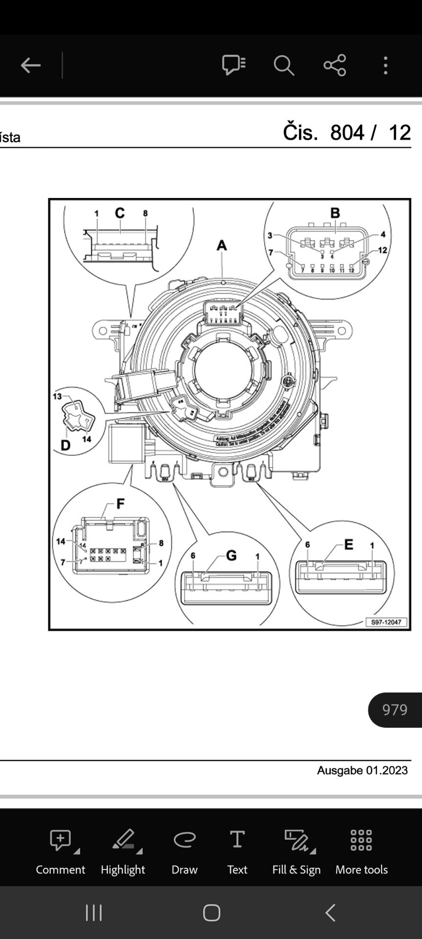

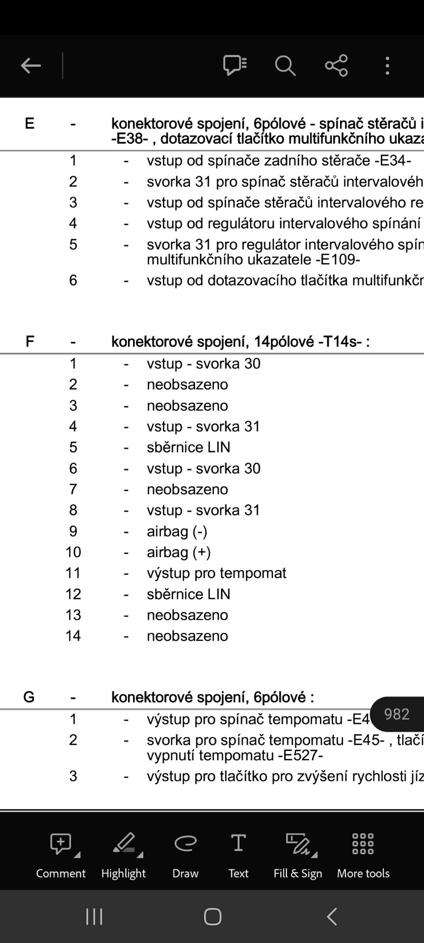

Screenshot_20250803_220425_AdobeAcrobat.thumb.jpg.98be04c829b5aaea34f270f78557f459.jpgScreenshot_20250803_220442_AdobeAcrobat.thumb.jpg.e2d6c7c41a44232d58e4aa95fd9af1c0.jpg

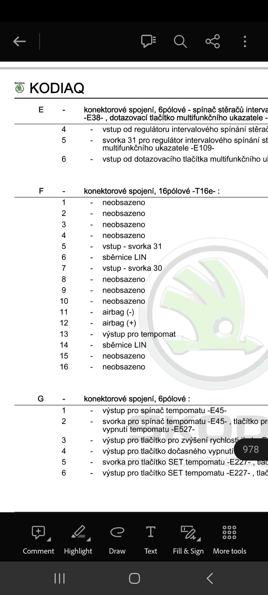

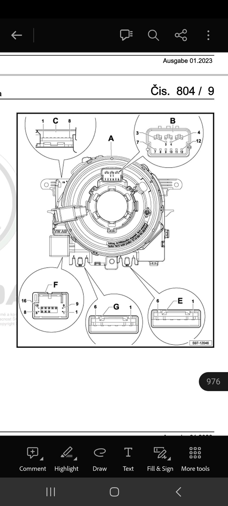

toto obsadenie pinov mas koncovka F 16pin
Screenshot_20250803_220353_AdobeAcrobat.thumb.jpg.40343bfaf3d96216016458284c15d66c.jpgScreenshot_20250803_220404_AdobeAcrobat.thumb.jpg.16fad699fa3c213e96ca475a1f3ccdb4.jpg
Takto potrebujes prepinovat novu koncovku F 14pin, nove vodice poloha 1 a 8 (https://www.skoda-diely.sk/nahradny-diel/5q0972726-svorkovnica-14-polova-skoda-45044.html)
Ak mas volant staci ti zohnat vhodny podvolantovy kruzok. Pozor na podporu funkcii ktore mas v aute na packach.
