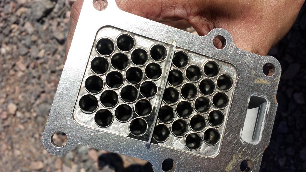

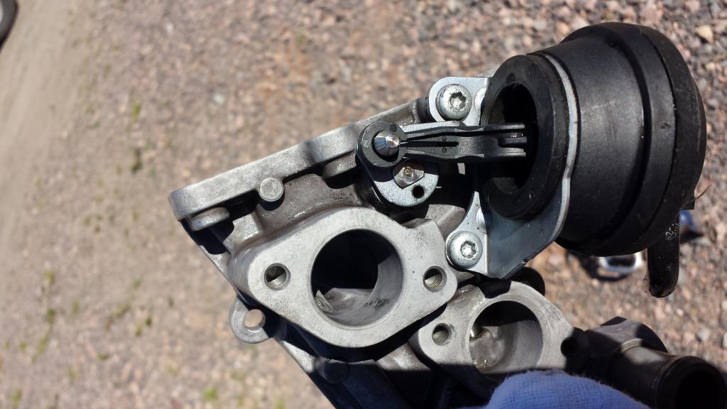

pridam par fotek k ERG ventilu oct II 2.0 103kw CR kod motoru CFHC MR2012 najeto cca 180 kkm
celek
post-24213-0-65492500-1408962934_thumb.j
chladic pred vycistenim
post-24213-0-69176600-1408962983_thumb.j
chladic po vycisteni supermafrasolem
post-24213-0-52812000-1408962964_thumb.j
egr po vycisteni
post-24213-0-38926700-1408962997_thumb.j
po vycisteni
post-24213-0-07492900-1408963016_thumb.j
nicmene po vycisteni motor jiz nepada do nouzoveho rezimu ... ale sviti mi kontrolka a zobrazuji se chyby
P1440 00 [175] - Open Circuit
P0405 00 [175] - Signal too Low
